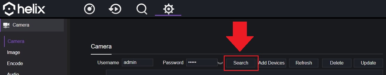

Step 2: Click on the Settings icon (gear wheel) and select Camera. Click Search.

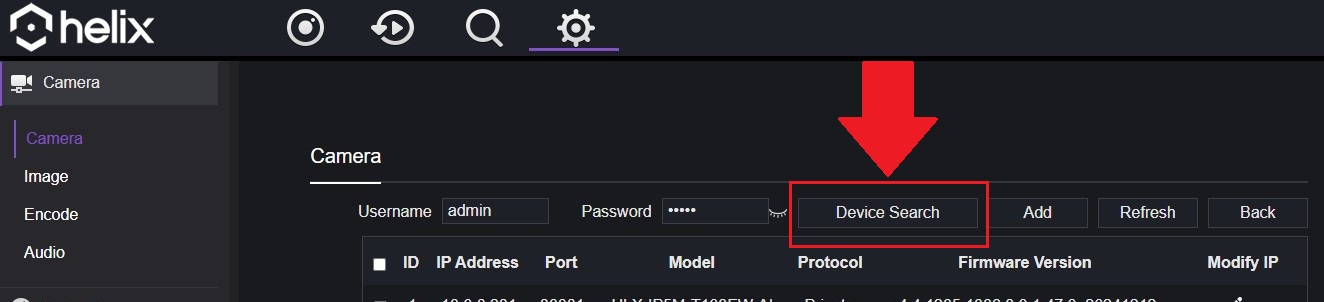

Step 3: Click Device Search.

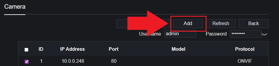

Step 4: Select your devices from the device list. The device will have a default ONVIF protocol in the interface, click Add. After it has been added, click Back to exit the menu.
Step 5: If the camera is set to default, the password will be admin and will register as online (green), however, if the camera is red, the password may need to be entered manually. To modify the device password, click the pencil icon under Operate. Enter the camera's password and click OK.
Step 6: The camera will register as online and ready for use.
