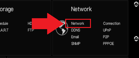

Step 2: Log into the local interface of your device and access the main menu. Click Network.

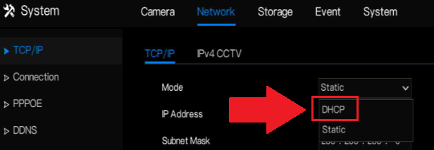

Step 3: In the TCP/IP menu you will notice a Mode checkbox, set the mode to DHCP, and click Apply.

Step 5: Log back into your device and go back to the Network menu. In the TCP/IP menu click on the DHCP toggle switch to set the device back to a static IP. You should be able to access the web user interface using the newly assigned IP address from the network.
