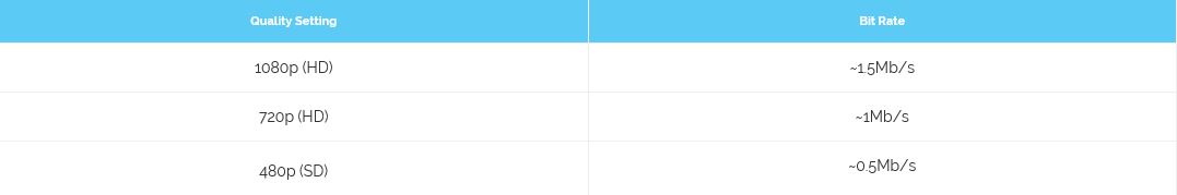

Upload Speed
Bandwidth plays a big part in reviewing the camera through Amcrest Cloud. With a low upload speed you may have delays logging into the camera interface, the camera video feed may be choppy or have a black screen, the recordings may be less than 30 seconds or appear to have ghosting images.
For optimal remote viewing of the camera we recommend an upload speed of 2Mb/s per camera to avoid latency, recording issues, and other networking limitations.
If you're unable to view your camera or find recordings to playback on your cloud account with your connected network, you may have an upload speed less than required for the desired video quality. Lower the video quality of the camera to the optimal speed approximation listed below.
