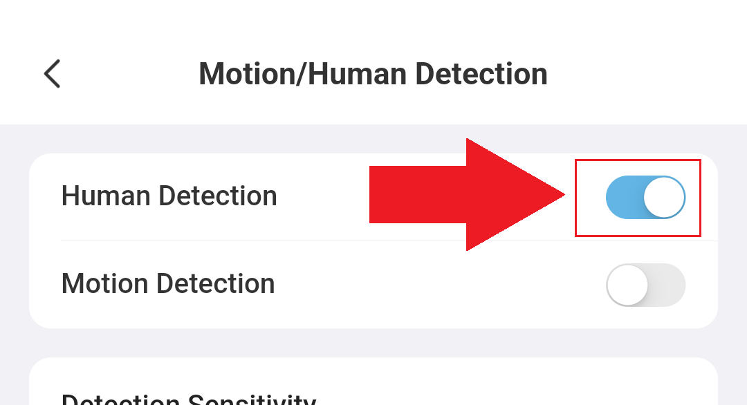

Step 2: Open the Motion/Human Detection menu and make sure to disable the Motion Detection option and that only Human Detection is enabled. This will ensure the device only detects human events in the detection area.

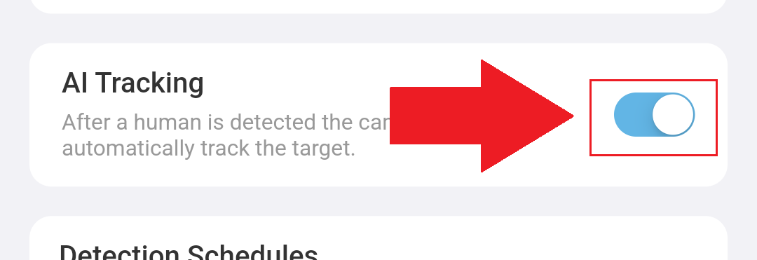

Step 3: Enable the AI Tracking option, once a human is detected, the camera will begin tracking the object until it is out of frame of the detection area.
