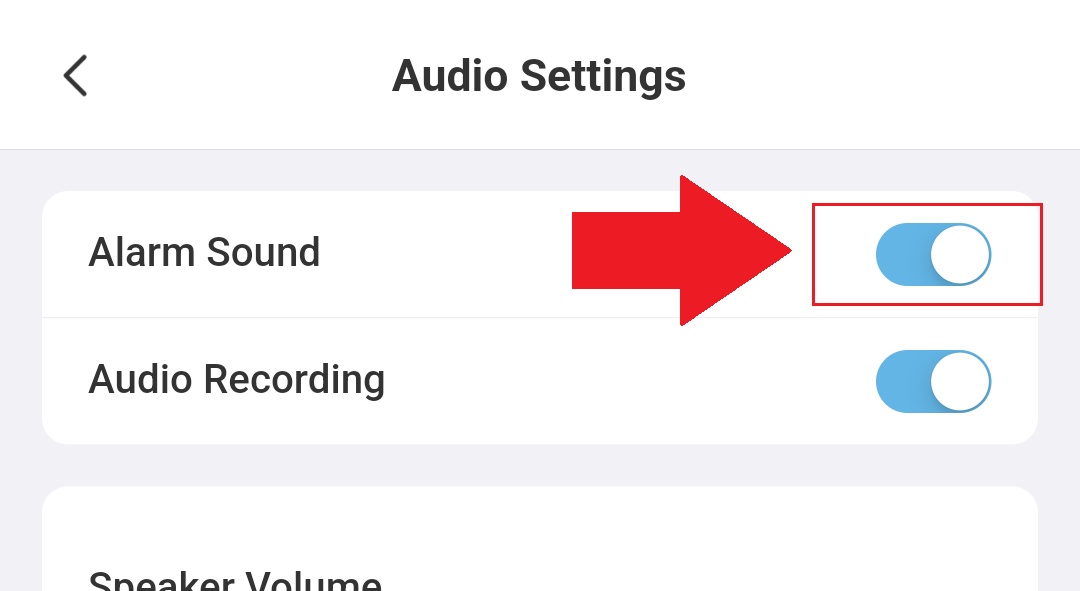

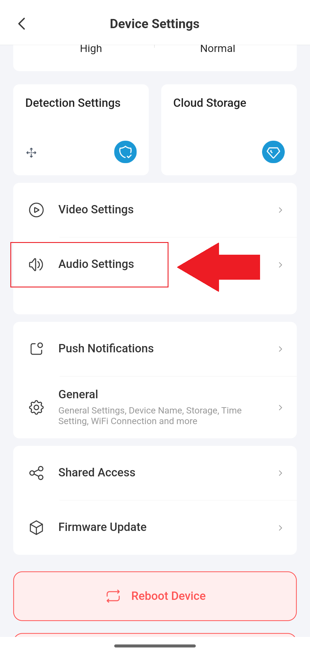

Step 2: Tap Audio Settings.
Step 3: Enable the Alarm Sound option. Adjust the speaker volume and set a "siren cycle" if needed. A siren cycle is the amount of times the alarm will sound after it is triggered. Exit the interface.

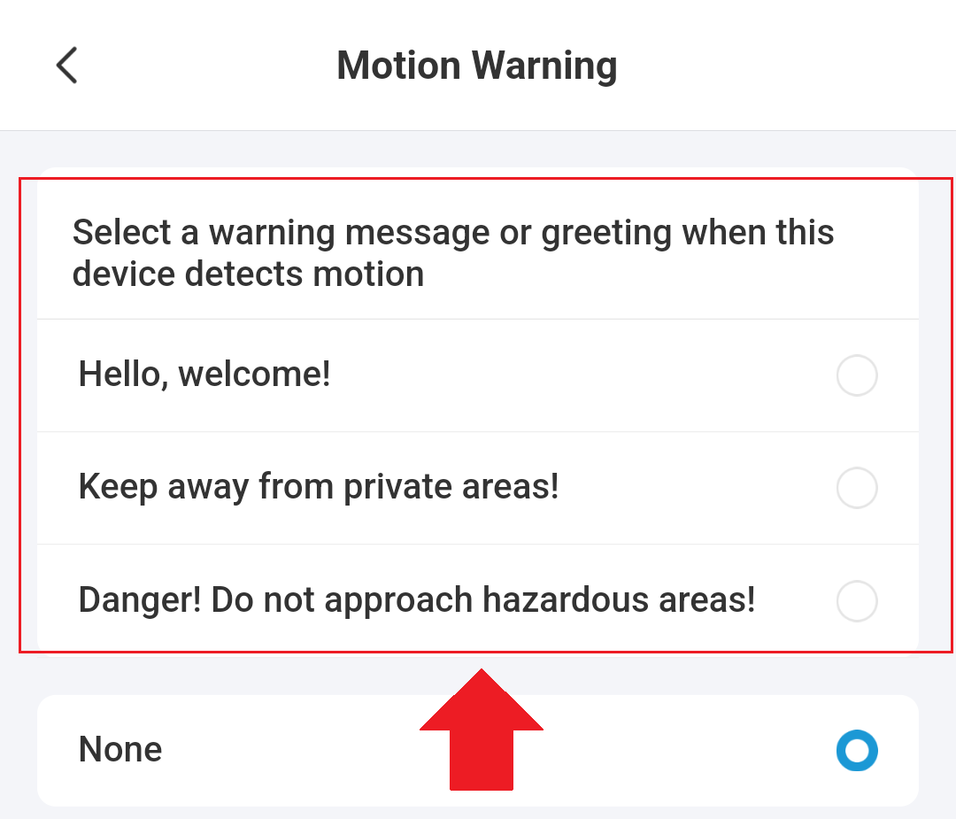

Step 4: Tap Detection Settings and access the motion/human detection menu. Scroll down to the Motion Warning menu and select a message. The alarm will sounds once a motion/human detection event is triggered by the camera.
