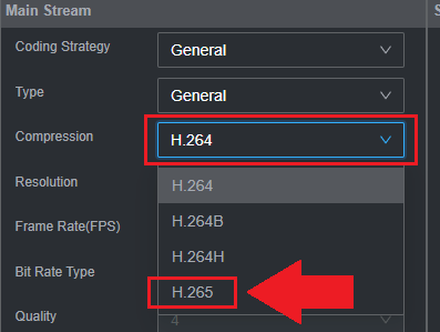

Step 2: In the Management section, click on Camera and access the Encode menu. In the Encode menu, choose a connected device from the Channel list. Locate the Compression dropdown menu and select H.265.
Step 3: Click Apply to save your settings.

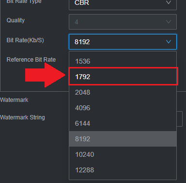

Since H.265 compression uses roughly 30% fewer resources than H.264, the camera will typically come default to a preset bitrate when switching to H.265. For instance, when switching to H.265 on a 4K camera, the bitrate may be defaulted to 8192 Kb/S, however, adjusting the bitrate to a lower value may help to increase the efficiency of the camera while viewing playback or watching the live view.
To adjust the bitrate, access the Encode menu and click on the Bit Rate (Kb/S) dropdown menu. A list of preset bitrates will be displayed as well as a Customized selection which will allow you to set a customized bitrate if needed. Please note, when using a 4K camera, it is recommended to keep the bitrate around 1792 Kb/S, however, different values may be applicable depending on your specific network requirements.
Note: In this menu, you will notice a Bit Rate Type menu, this dropdown menu allows you to choose between a constant bitrate (CBR) or a variable bitrate. A constant bitrate allows the bitrate to remain constant whereas a variable bitrate allows the system to choose a bitrate. It is highly recommended to keep the bitrate type as CBR to keep the bitrate consistent.

Note: Adjusting the bitrate to anything lower than the recommended bitrates above may result in degradation to recordings or to live view. For best results, if you are adjusting multiple cameras, it is highly recommended to adjust each camera individually. This may be a trial and error process since most network environments are unique and may vary, however, the bitrate should range between 1792-2048 Kb/S if using a 4K camera. An optimal customized bitrate should be around 1825 Kb/S.
Click Apply to save the adjusted bitrate settings.

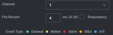

Log in to the web UI for your device and click on Management and select Storage.
By default, General (24/7), Motion (Motion Detection) and IVS recording types will be activated for all days as indicated by the different colored bars available in this menu.
