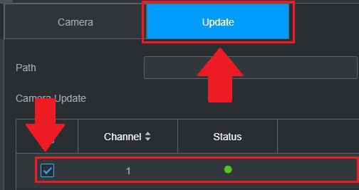

Step 3: Click on the Update tab and select the device you would like to upgrade.

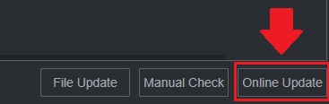

Step 4: Click Browse and locate the firmware file you downloaded from the Amcrest firmware download page. Click Online Update and allow the camera to update.
Note: All recording on the camera must be disabled for the upgrade to go through, the camera may also reboot once the upgrade is complete.
