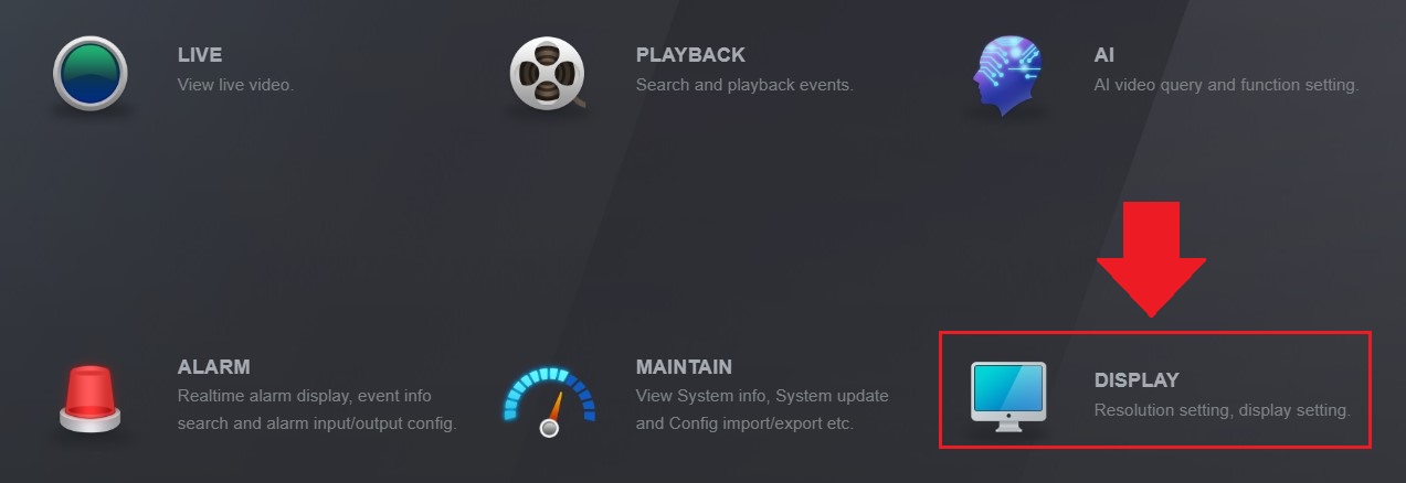

Step 2: Select Display.

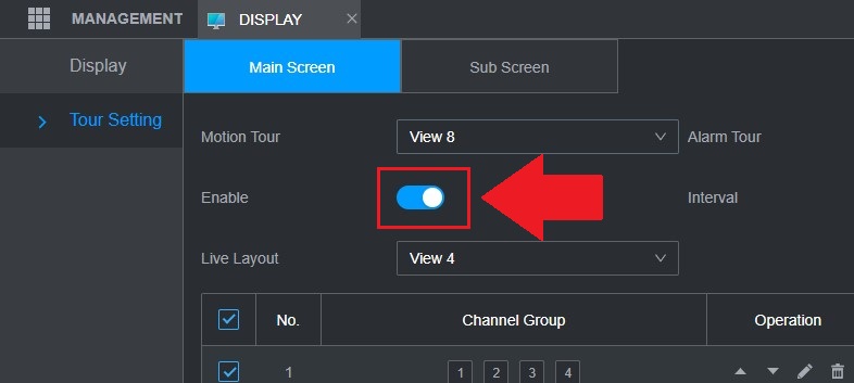

Step 3: Select Tour Setting and click Enable.
The Motion Tour option can be used to allow the cameras in a selected group to automatically move to areas where motion is detected. Set the Live Layout option allows you to create a custom layout of your camera views that can be used  during a tour. This provides a more interactive and visually appealing way to monitor multiple areas simultaneously. Set the Interval to the amount of time you would like each view to display before it is switched to a different channel.

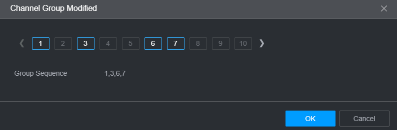

Step 4: To create a new custom tour group (which channels will be applicable to the tour) click Add option and select which channels to apply to the tour. To modify an existing tour, select the tour group and select Modify. Select which channels will apply to the tour and click OK.

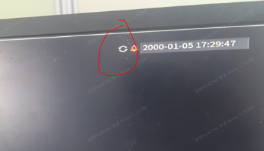

Step 5: Click Apply to save the tour settings. The selected channels will have a tour icon on the local UI indicating a tour is applied to that channel.
