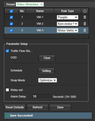

Step 1: Navigate to  Event>>Video Metadata. Click the (+) icon in the video metadata menu to begin adding video metadata rules.
Please note, a max of 3 video metadata rules can be applied. Click the (+) button to add additional rule types if needed. Use the rule type dropdown menu to select a specific video metadata rule type that will be applied.
Below is a description of the options in the metadata menu.
Preset: Use this dropdown menu to select a preset. Please note the preset and smart plan must be enabled to add any video metadata rule types.
No.: Provides the order in which the video metadata rules will be displayed in the menu.
Name: This allows the user to customize a name for their rule. Double click the name in the Name column to modify.
Rule Type: Use the rule type dropdown menu to select a video metadata rule.
(+): Used to add a video metadata preset into the interface.
People Flow Statistics: Enable this checkbox to allow flow statistics to be displayed in the OSD overlay.
Schedule: This allows the user to set a schedule in which video metadata will be triggered.
Relay Out: This checkbox allows the user to enable the camera to trigger a connected alarm (connected to the alarm port on the back of the camera) when a motion detection alarm is triggered.
Alarm Delay: This field specifies in seconds how long the delay between alarm activation and Relay alarm activation should be.
Detect Region: This option is used to set a face detection area. The area will be full screen by default.
Clear: This option is used to clear any face detection areas currently set.
Exclude Region: This option is used to set an area in which the face detection rule will not apply.
Clear: This option is used to clear any excluded face detection areas.
Target Filter: This option allows the user to set a maximum and minimum size of the target area. By default, this option will be set to the max resolution, however, it can be manually adjusted.
Draw Target: This allows the user to set a target area on the live monitor screen.
Clear: Clears the modified target area to draw the target area on the live monitoring screen.
Pixel Counter: Used to measure and set the number of pixels in the target area on the live monitoring screen.
To reset to default settings, click the Reset Defaults button. To refresh the page, click the Refresh button. To save the settings, click the Save button.
