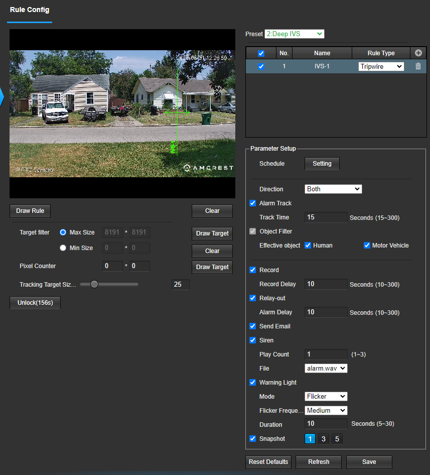

Setting a Tripwire
A tripwire rule allows the camera to trigger an event if an object, such as a human or vehicle, crosses the set tripwire line.
Step 1: Select Tripwire from the Rule Type drop-down menu. Set a name for the rule by double-clicking the mouse over the Name of the rule.
Step 2: Click on Setup to set a schedule, set your periods (if any), and click Save to continue.
Step 3: In the Direction menu, choose which direction the object will be going for the tripwire to be triggered. To have the tripwire detection motion in both directions, choose A<->B. This model features Alarm Track, which allows the camera to automatically track the detected object until it is out of view.
Step 4: Enable the Record checkbox to record the event.
Step 5: Check the Send Email and Snapshot checkboxes if you would like a snapshot of the event emailed to you. A valid email address must be established in the camera prior to enabling this setting. Enable the Siren or Warning Light options to activate the active deterrents once the rule is triggered.
Step 6: Click the Draw Rule option and use your mouse to draw the rule on the live monitoring screen. Once the rule has been drawn click the monitoring screen to finish setting the rule.
Note: The target filtering and pixel counter can be used to refine the set rule however for optimal experience it is highly recommended to leave these settings as default
To reset to default settings, click the Reset Defaults button. To refresh the page, click the Refresh button. To save the settings, click the Save button.

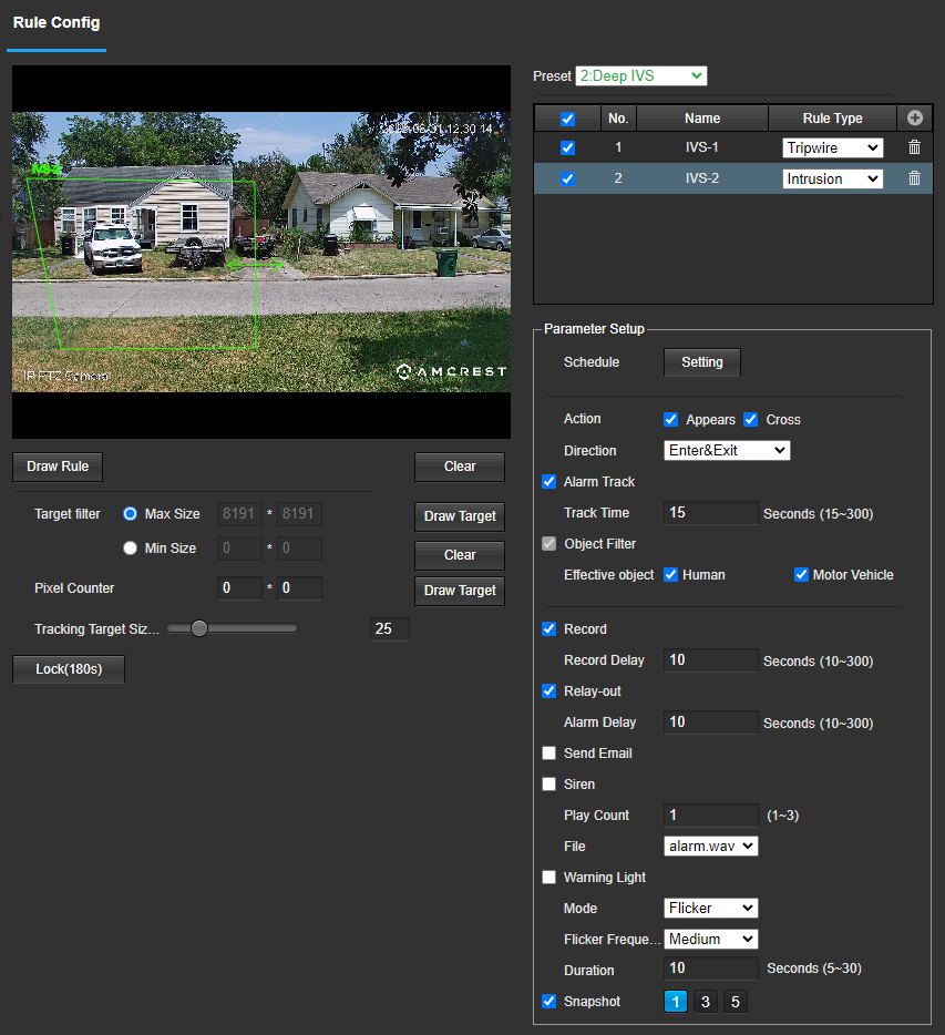

Setting an Intrusion Rule
An intrusion rule allows the camera to trigger an event if an object, such as a human or vehicle, appears or crosses a set intrusion area set by the user.
Step 1: Select the Intrusion rule from the Rule Type dropdown menu. Set a name for the rule by double-clicking the mouse over the Name of the rule.
Step 3: In the Action menu, choose whether the rule will be triggered if an object appears or crosses the set region. Both options can be enabled at the same time if needed.
Step 4: In the Direction menu, choose if the rule will be triggered if the object enters only, exits only, or enters & exits a set region. This model features Alarm Track, which allows the camera to automatically track the detected object until it is out of view.
Step 5: Enable the Record checkbox to record the event.
Step 6: Check the Send Email and Snapshot checkboxes if you would like a snapshot of the event emailed to you. A valid email address must be established in the camera prior to enabling this setting. Enable the Siren or Warning Light options to activate the active deterrents once the rule is triggered.
Step 7: Click the Draw Rule option and right-click on the live monitoring screen. Use the mouse to draw your initial line. Once the initial line is set, right-click the mouse again to continue drawing the region. Repeat the process and left-click the mouse to complete the region. Right-click on the live monitoring screen when finished to set the rule.

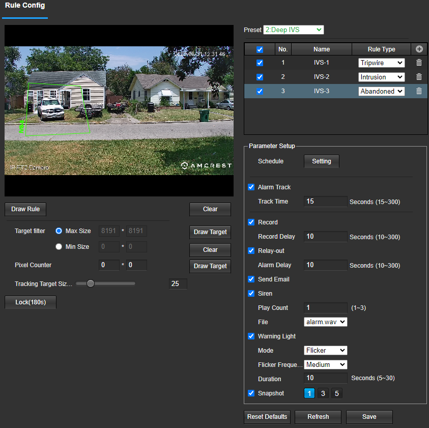

Setting an Abandoned Object Rule
An abandoned object rule allows the camera to trigger an event if an object is placed in a set area for a specified amount of time.
Step 1: Select the Abandoned Object rule from the Rule Type menu. Set a name for the rule by double-clicking the mouse over the Name of the rule.
Step 2: Click on Setting to set a schedule, set your periods (if any), and click Save to continue. This model features Alarm Track, which allows the camera to automatically track the detected object until it is out of view.
Step 3: In the Duration menu, type in the number of seconds you would like to have before the device triggers an event. For best results, it is recommended to keep this option as default (10 seconds).
Step 5: Enable the Send Email and Snapshot checkboxes if you would like a snapshot of the event emailed to you. A valid email address must be established in the camera prior to enabling this setting. Enable the Siren or Warning Light options to activate the active deterrents once the rule is triggered.
Step 6: Click the Draw Rule option and right-click on the live monitoring screen. Use the mouse to draw the initial line. Once the initial line is set, right-click the mouse again to continue drawing the region. Repeat the process and left-click the mouse to complete the region. Right-click on the live monitoring screen when finished.

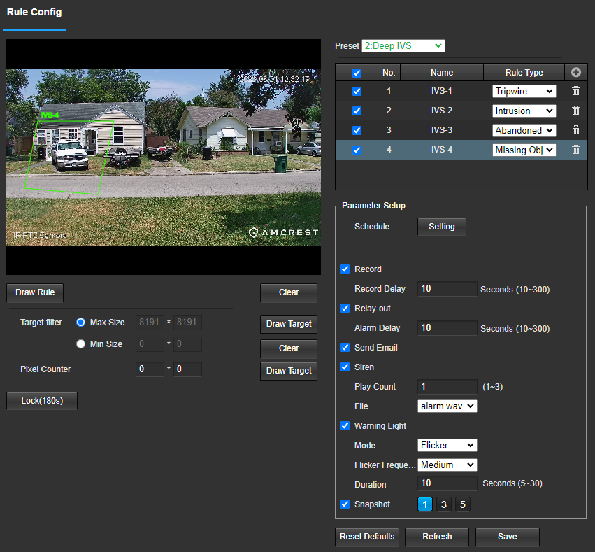

Setting a Missing Object Rule
A missing object rule allows the user to set a region around an object and if the object is moved or missing from the set region an alarm will be triggered.
Step 1: Select Missing Object from the Rule Type menu. Set a name for the rule by double-clicking the mouse over the Name of the rule.
Step 5: Set the number of seconds the event will be delayed in between triggers. It is recommended to leave this as default.
Step 6: Enable the Send Email and Snapshot checkboxes if you would like a snapshot of the event emailed to you. A valid email address must be established in the camera prior to enabling this setting. Enable the Siren or Warning Light options to activate the active deterrents once the rule is triggered.
Step 7: Click the Draw Rule option and right-click on the live monitoring screen. Use the mouse to draw your initial line. Once the initial line is set, right-click the mouse again to continue drawing the region around the object. Repeat the process and left-click the mouse to complete the region. Right-click on the live monitoring screen when finished to set the rule.
