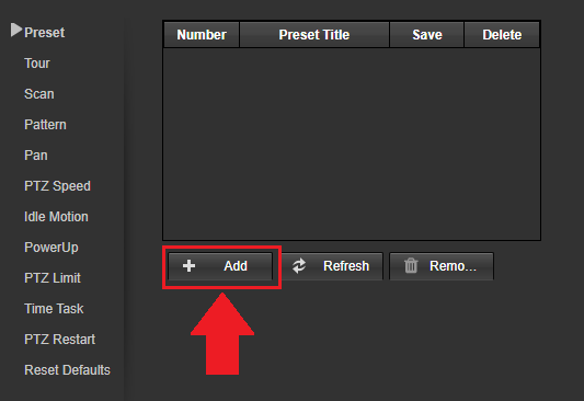

Step 2: Click on Setup>>PTZ to access the Function tab and click on Add.

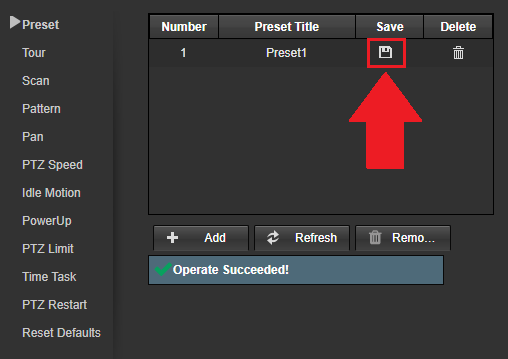

Note: To change the name of the preset, double click on the preset title and enter the title of the preset into the interface. Click the Save icon to save your presets.

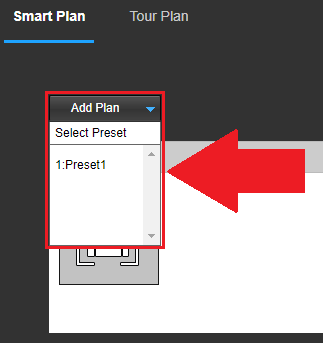

Step 3: Click on Event>>Smart Plan, click on Add Plan, and select your preset from the dropdown menu.

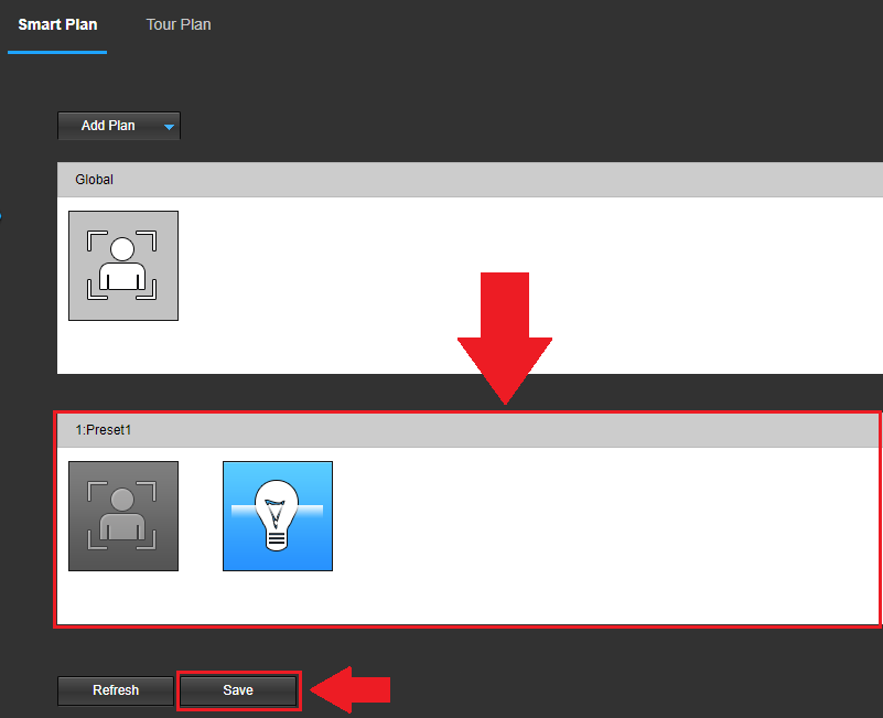

Step 4: Select which AI rule the smart plan will apply and click Save to enable the smart plan.
Note: A separate preset will need to be added and an additional smart plan will need to be enabled for the multiple categories. Once the smart plan is enabled, the AI feature settings can then be enabled.
