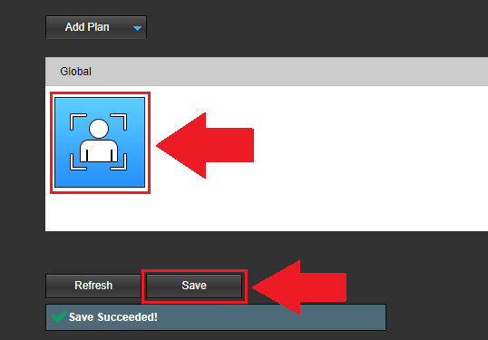

Step 2: Click on Setup>>Event>>Smart Plan and ensure a Face Detection smart plan is enabled. Click Save.
