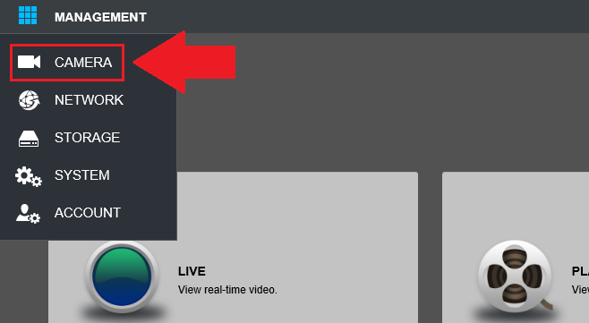

Step 3: Under the Management section click on Camera.

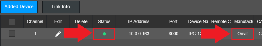

Step 5: Click the Edit icon (pencil) and enter the password for your Reolink camera. Click Save.
Step 6: Select the device in the Remote Device menu and click Refresh. The status of the camera will change from red to green indicating the camera has been properly registered to the NVR using ONVIF.
