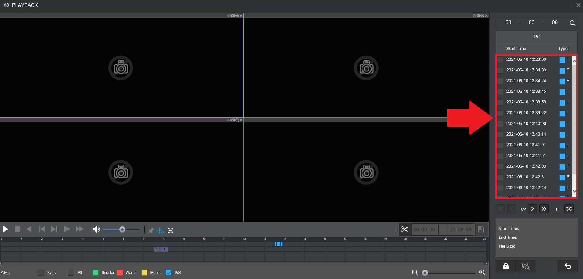

To filter between different recording types in the playback menu, use the record type selection banner at the bottom of the interface.
The device will be set to display all recording types in the file list. To display only AI recordings in the file list, deselect the All checkbox and enable the IVS checkbox only. Click on the File List icon to display the record types.
