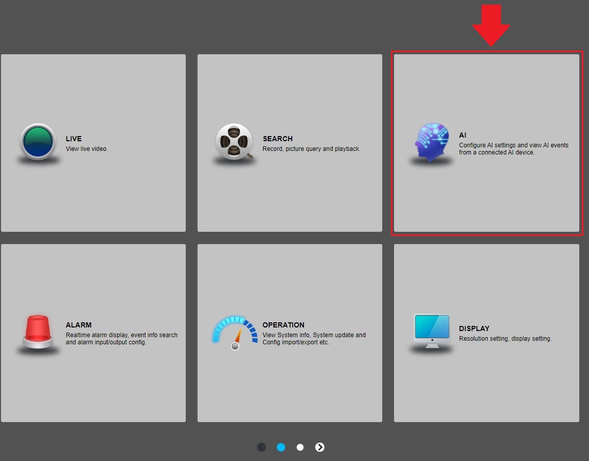

Step 1: Log into the NVR directly or using the NVR's web user interface (web UI) using a web browser and select AI from the main menu. For more information on how to access the web UI for your device, click here.

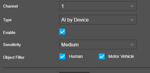

Step 2: Select SMD in the Parameters menu. Use the object filter option to set the camera to detect human or vehicle events. Both filters can be used simultaneously if needed. Click Enable
Step 3: Enable any additional notification features and click Apply
