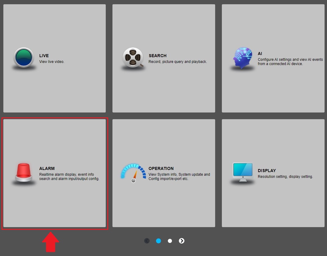

Step 1: Log into the NVR directly or using the NVR's web user interface (web UI) using a web browser and select Alarm from the main menu. For more information on how to access the web UI for your device, click here.

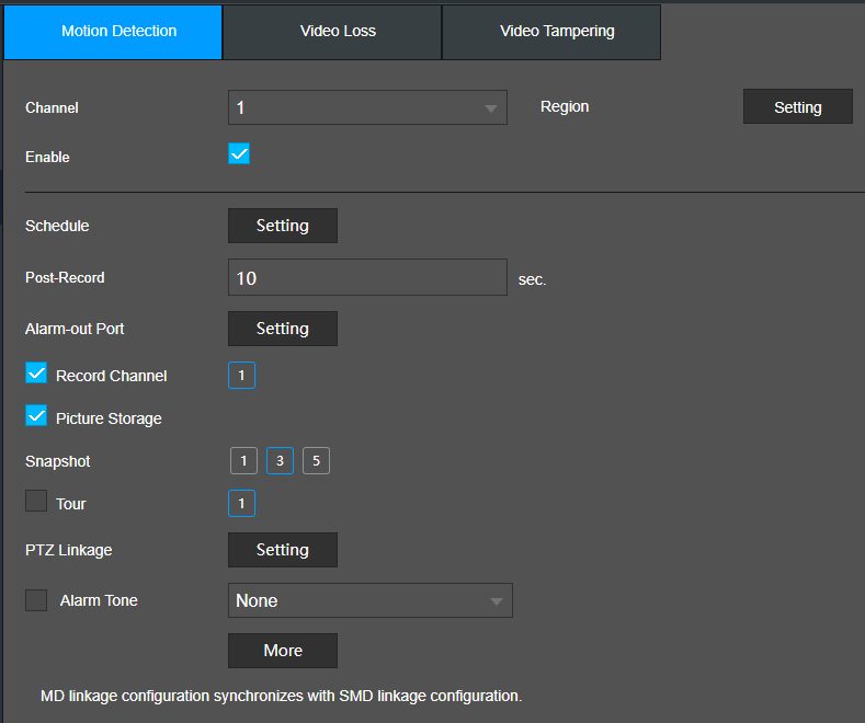

Step 2: Select Video Detection to access the Motion Detection menu. This is the main configuration page for your motion detection settings. Select which channel you are configuring from the Channel drop down menu and select Enable.
Step 3: Select any notification or additional settings and click Apply.
