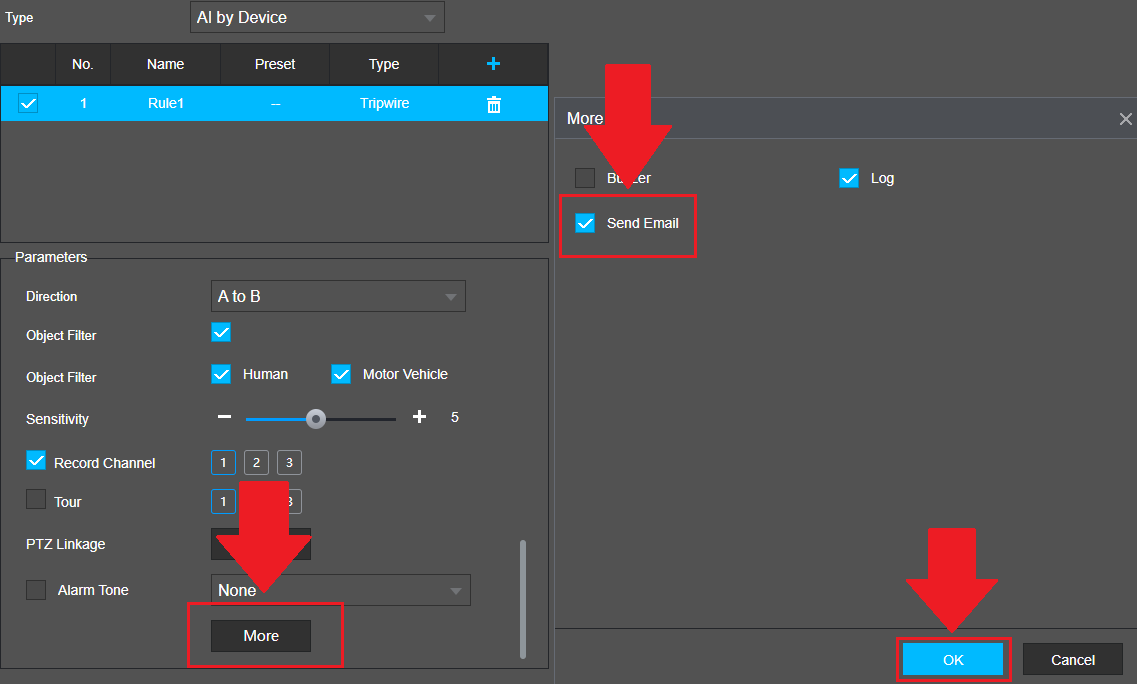

Emailing IVS Event Snapshots
To have snapshots of the event emailed to you, you will first need to set up email alerts on the NVR. For more information on how to set up email alerts, click here.
Once the email alerts have been properly set in the system, navigate to the IVS settings you are using and click More, select Send Email, and click OK
Click Apply in the interface to save the settings.
