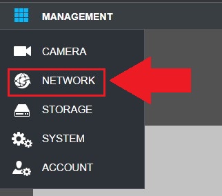

Step 2: Click on Management and select Network.

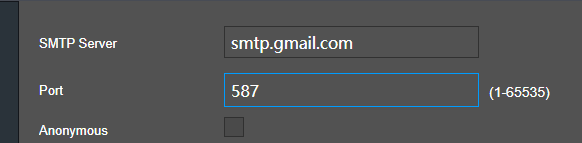

Step 2: Select Email and enter the SMTP information for your email provider. In this example we will be using Gmail, however other email services can also be used. If using Gmail, type in “smtp.gmail.com”
Step 3: Enter a port number. This is based on the type of encryption used by your email service. In this example we will be using port 465, which uses an SSL encryption type. If using TLS, the port number will be 587.
