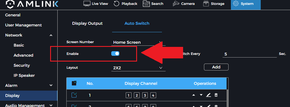

Step 2: Open the System option, select Display, access the Auto Switch menu, and enable this option.
Note: The duration of the tour can be modified in the "Switch Every" menu.

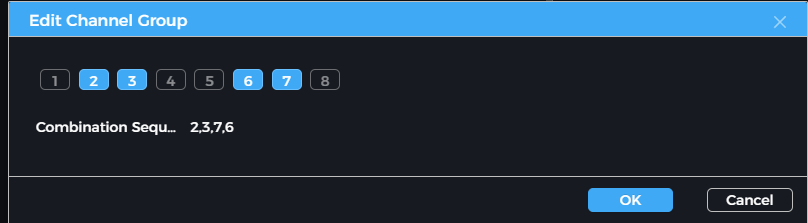

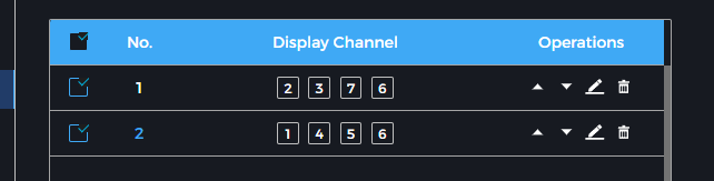

Step 3: Select a layout, by default it will be 2x2 however other layout options can be selected as well if needed. Once a layout has been selected click the Edit icon in the Operations menu to set the applicable channels for the tour. For instance, in the image below we are having the NVR tour channels 2, 3, 7, and 6 every 5 seconds.
The process can be set for the remaining channels as well for the remaining channel group.
Step 4: Click Apply to save the tour settings. The selected channels will have a tour icon on the local UI indicating a tour is applied and running on your NVR.
