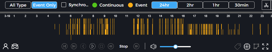

Step 3: Select a channel in the Channel Name menu and use the calendar to select a date with available events. A date with recordings will have a dot below the number in the calendar.
The events for that day will be displayed in the timeline. To view only event recordings for that day, click the Event Only option. Use your mouse to scroll through the timeline if needed.
Note: To view human and vehicle events only, please download and install the plugin for the browser and select the human or vehicle icon to filter and view these recordings.
Step 4: Use the clip option to clip and download events from the timeline. To use the clip feature, click the scissors icon and enter the start and end time of the event you want to clip. Click the Save icon and set a file path for the recording from the NVR to your computer.
