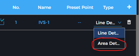

Step 3: Click the "+" icon, and select the Area Detection option.

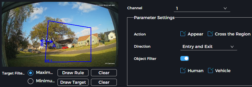

Step 4: Use your mouse to draw a detection area on the interface. Once the area is drawn click the interface to set the detection area.
• Set the Action options to define specific behaviors that will trigger the event.
Appear: Triggers as soon as an object is first detected inside the zone.
Cross the Region: Triggers only when an object moves across the boundary line of the zone.
• Set the Direction options to set the flow of movement required to trigger an event.
Enter: Only triggers when an object moves from outside to inside the zone.
Leave: Only triggers when an object moves from inside to outside.
Entry and Exit: Triggers for any movement across the boundary in either direction.
The feature will be set to trigger if a human or vehicle crosses the detection area, however, the rule can be set to human only or vehicle detection only. Use the Object Filter options to modify these settings if needed.

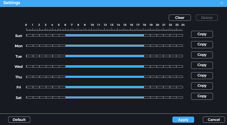

Step 5: A schedule option will be provided, this allows you to customize when the feature will be active on your device. To customize a the schedule click the Settings option in the Schedule field. Click Clear and use your mouse to set the time. For instance, if you would like the rule to only apply at 6am till 6pm all week, click and drag the applicable area on the interface. Click Copy to apply the schedule to other days of the week then click Apply.
