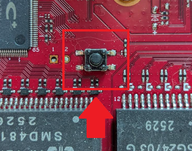

Step 1: Open the cover of the NVR and locate the factory reset button.
Step 2: Turn off the device or remove it from power, press and hold the reset button and turn the NVR back on or power it back up. Continue to hold the reset button until you hear a beep and release. Allow the NVR to reboot and reset back to its original factory default.
