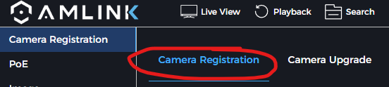

Step 2: Click on the Camera and access the Camera Registration tab.

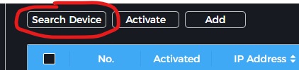

Step 3: Click Search Device.

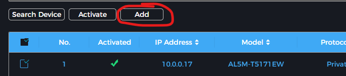

Step 4: Select your devices from the device list, click Add.
Note: If the device is not activated, select the device and click Activate. Follow the steps to activate the device before adding it into the system.

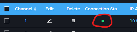

Step 6: The camera will register as online and ready for use. The same process can be applied to other channels as well if needed.
