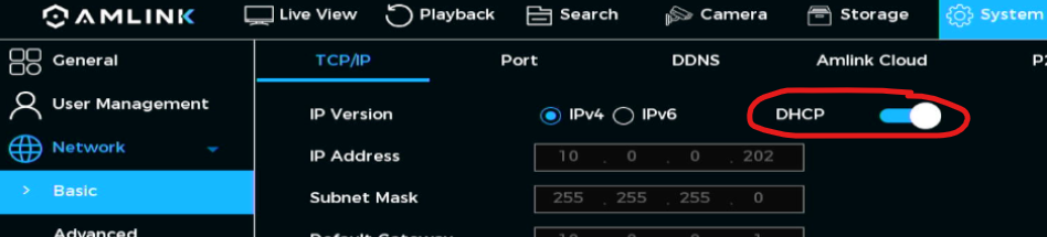

Step 2: Log into the local interface of your device, click on System>>Network>>Basic. Make sure the mode is set to DHCP and click Apply.
Step 3: Once the NVR has been set to DHCP mode, unplug the device from power leaving the Ethernet cable plugged into your network. Wait for about 30 seconds and plug the power adapter back into the device.
Step 4: Log back into your device and go back to the Network menu. In the TCP/IP menu click on the DHCP toggle switch to set the device back to a static IP. You should be able to access the web user interface using the newly assigned IP address from the network.
