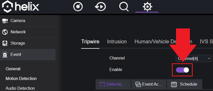

Step 2: Select the settings option and navigate to Event>>IVS>>Tripwire and enable the feature for the applicable channel.

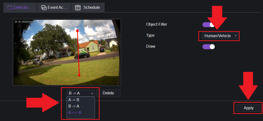

Step 3: Use your mouse to customize the detection line. Use the directional dropdown box to set how the object passes through the line to trigger the event, A->B (left to right), B ->A (right to left), A<->B (both directions). If using a Helix camera that supports human and vehicle detection, use the Type dropdown menu to select human only, vehicle only, or human/vehicle detection.  Once the detection area and object filters have been applied click Apply.
