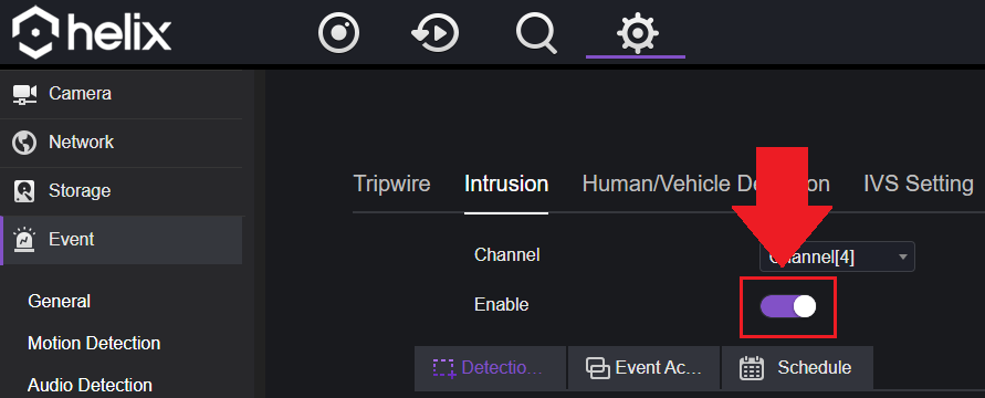

Step 1: Log into the NVR directly or using the NVR's web user interface (web UI). For more information on how to access the web UI for your device, click here.
Step 2: Select the settings option and navigate to Event>>IVS>>Intrusion and enable the feature for the applicable channel.

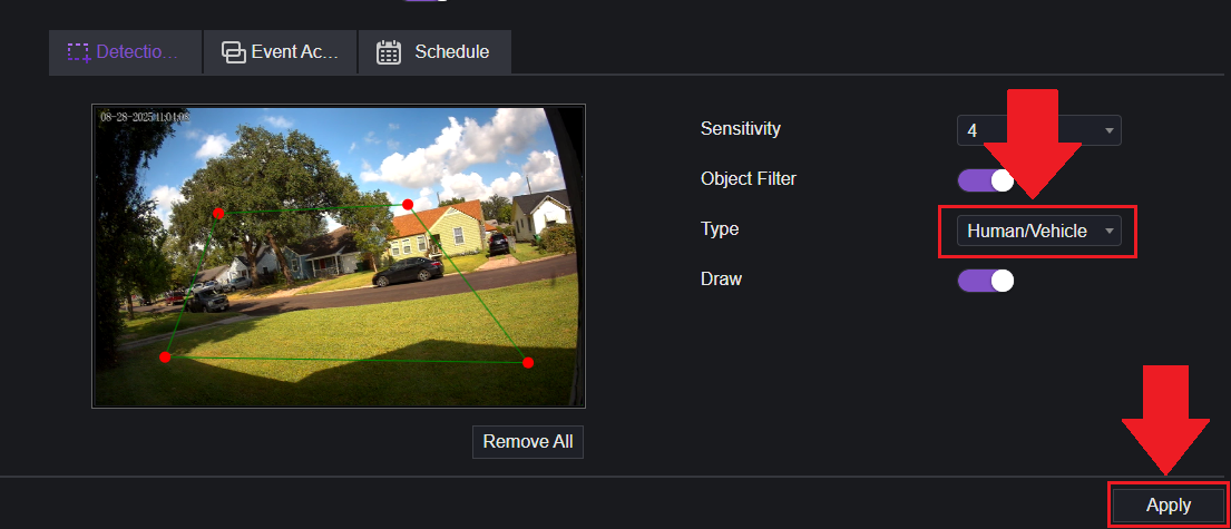

Step 3: Use your mouse to customize the detection area. It will be set to full screen by default however it can be adjusted to specific areas if needed. If using a Helix camera that supports human and vehicle detection, use the Type dropdown menu to select human only, vehicle only, or human/vehicle detection.  Once the detection area and object filters have been applied click Apply
Additional event actions such as sending a email alert or other options can be applied in the event actions tab if needed. To set an optional schedule to apply to the events, click the schedule option and set the schedule.
