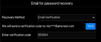

The password can be recovered using three methods, email, question, or QR Code verification. To access the password reset options, click the Forgot Password option located on the log in screen.
Select a password recovery method from the provided drop down menu.
Email Verification
The email verification option allows the device to send a password recovery email to you. This email will provide verification code to recover your email. Click the Send option to allow the device to send the verification code. Enter the verification code in the interface and click OK.

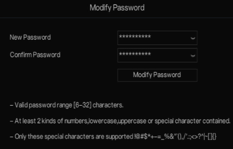

Enter a new password for your NVR and click Modify Password. Use the new password to log into your NVR.

The security question verification option can be used to recover your password if security questions were set in the device during initial setup. Enter the answers to the provided questions and click OK. Once the questions have been answered correctly, enter a new password for your NVR and click Modify Password. Use the new password to log into your NVR.
