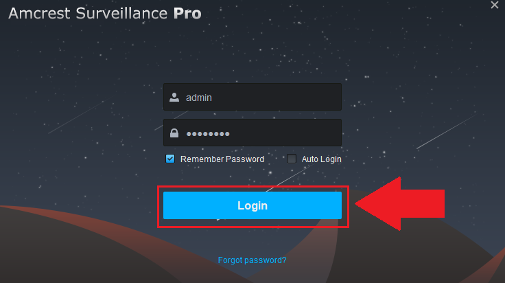

Step 1: Open and log into the Amcrest Surveillance Pro software.

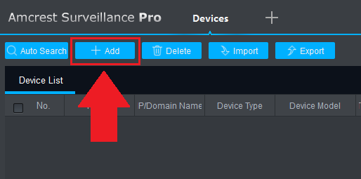

Step 2: Open the Devices menu and click on "Add".

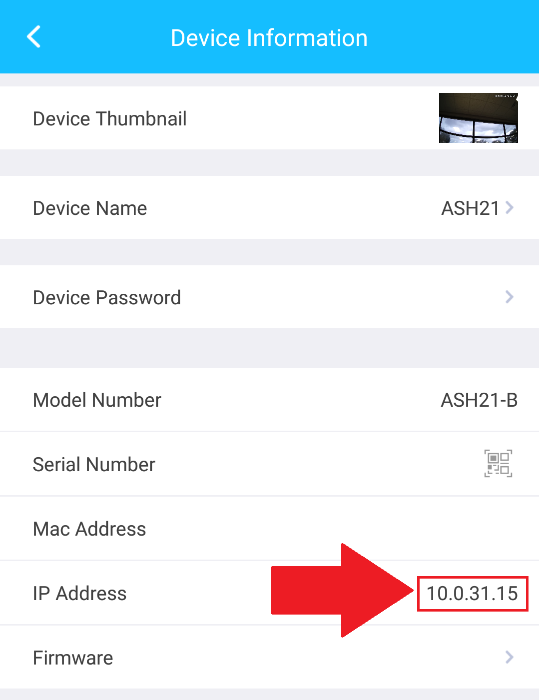

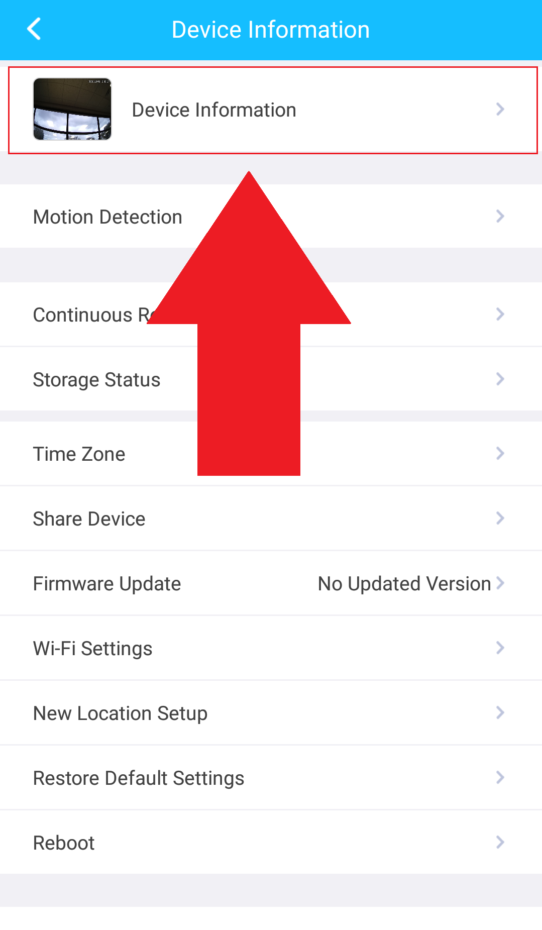

Note: The IP address for your camera can also be found by using the Amcrest Smart Home app. To access the IP address for your camera, log into your account on your Amcrest Smart Home app and select your camera from the Devices menu. Tap on the settings icon ( mceclip1.png ) and tap Device Information.
Scroll down until you see the field labeled " IP Address". This will be the IP address for your camera.

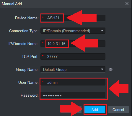

Note: The camera will not be able to add using the P2P method. Please use the IP/Domain connection type when connecting your camera to Amcrest Surveillance Pro.

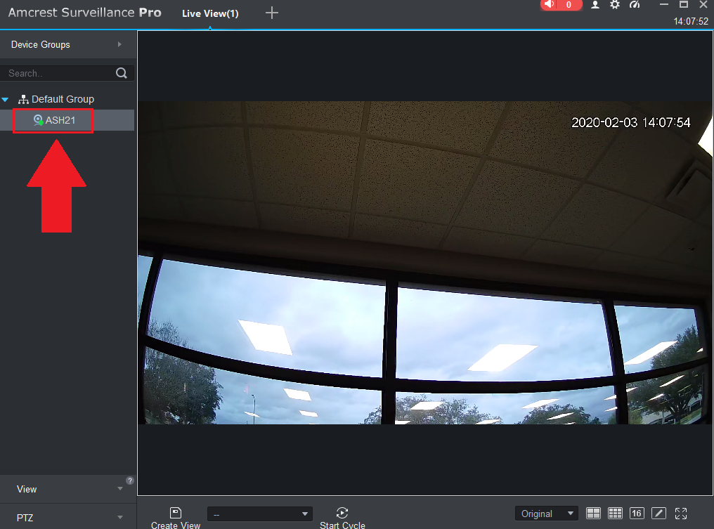

Step 4: In Amcrest Surveillance Pro, give your camera a name and then enter the IP address for the camera in the IP Address field

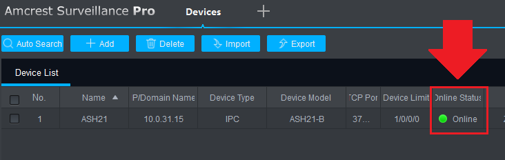

Enter the username and password for your camera and then press the "Add" button when you are finished. The camera has now been successfully added to the Amcrest Surveillance Pro software. Ensure the Online Status is green indicating the camera is properly connected.
Step 5: Navigate to the Live View option and locate the newly added camera in the assigned Group menu. Double click the camera to view the live feed.
