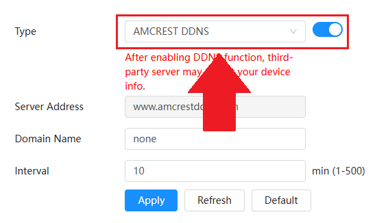

Step 2: After your device is port forwarded, navigate to the web UI and click on Network>>DDNS. Select AMCREST DDNS from the dropdown menu and enable the feature in the Type field.

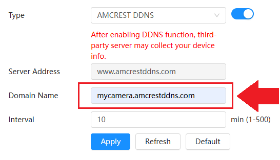

Step 3: Enter a Domain Name. Please note, it is highly recommended to use a unique domain name when setting up DDNS as any common names such as "amcrest" "camera", etc. may not work as it is already being used by other devices.
Step 4: Click Apply to save the DDNS settings to your device.

The DDNS address you will use to access your device will be formatted as follows in the web browser, "domainname.amcrestddns.com:port#" For instance, if you used "mycamera" as your domain name, and 37779 as the HTTP port number, the DDNS IP address used will be formatted as follows:  "mycamera.amcrestddns.com:37779".
The update period for your DDNS service will be set to 10 minutes. It is recommended to leave this as 10 unless otherwise instructed. If the domain name entered does not work please enter a different domain name into the DDNS interface and try again.
