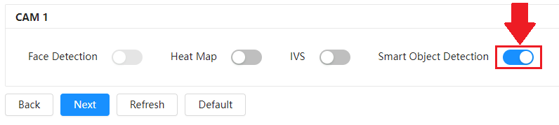

Step 2: Access the main menu and click on AI. Select a General or Schedule plan, if you would like more information on how different intelligence modes work on your camera, click here.
Step 3: Click Next. Select Smart Object Detection from the Smart Plan menu and click Next.

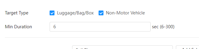

Step 2: Use your mouse to draw a detection area on the interface. Ensure the correct Target Type is selected and enter the minimum duration. If anything is left sitting in this area for the minimum duration set, the rule will be triggered.

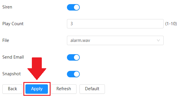

Step 3: Set any additional settings such as a siren, email alerts, etc. that can be set to trigger once an event is detected. Click Apply to set the settings to the camera.
