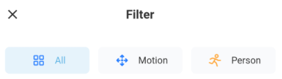

To view an event, select the event you would like to view and tap on the event. The app can also filter to only display motion or human detection events. Tap the filter icon and select a filter to display only those events for the day.
