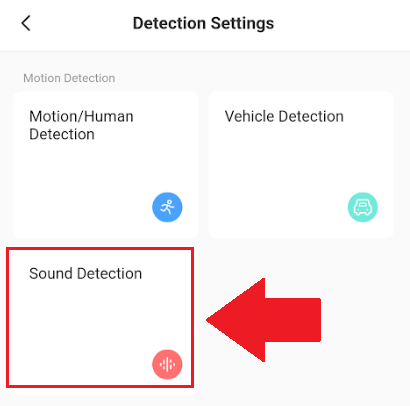

Step 1: Access the Detection Settings menu for your device and select Sound Detection.

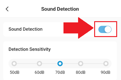

Step 2: Enable the Sound Detection option.
Note: The camera will be set to trigger an event if the sound in the area exceeds 70dB, however, it can be set in between 50dB - 90dB.

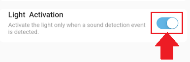

Step 3: Enable the Light Activation option to allow the light on the camera to flash or activate once the sound threshold has been exceeded. For more information on light settings, click here.
