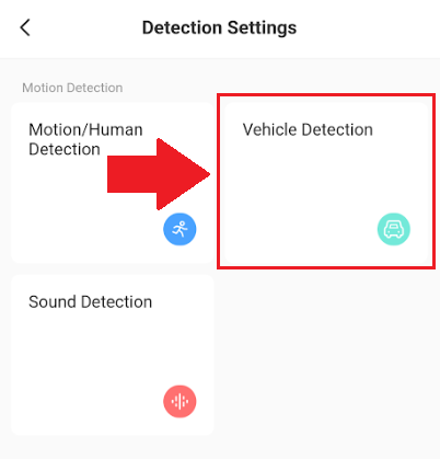

Step 1: Access the Detection Settings menu for your device and select Vehicle Detection.

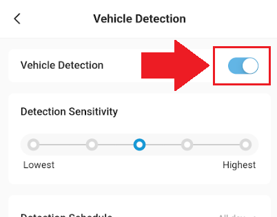

Step 2: Enable the vehicle detection option.
Step 3: The detection sensitivity options can be set to high, middle, or low if needed. The lowest setting will have the least amount of objects detected, while the highest sensitivity will have more events. It is highly recommended to keep sensitivity as default (middle) for best results.

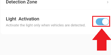

Step 5: Enable the Light Activation option to allow the light on the camera to flash or activate once a vehicle is detected. For more information on light settings, click here.
