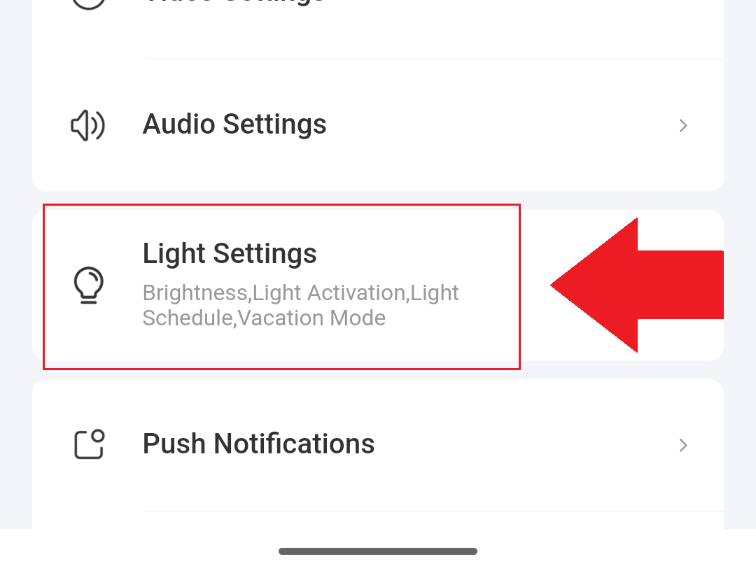

Open the Amcrest Link app, select Settings, and tap Light Settings.

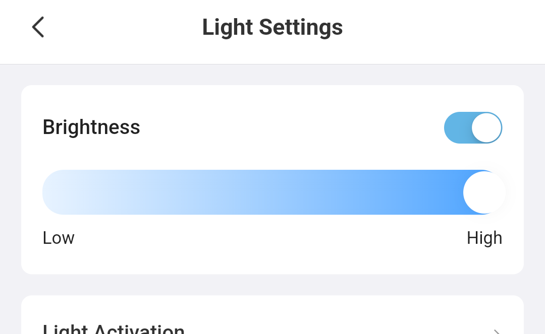

Enable the Brightness option and use the slider to raise or lower the intensity of the light bulb.

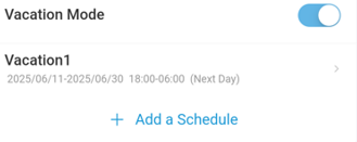

Enable the vacation mode option to set the camera to activate the light for longer periods of time. For instance, in this example, we have the vacation name set as vacation1, the effective date will be June 11th – June 30th and the light will turn on at 6pm and will turn off on the end time, 6am the next day. Tap Save.
The vacation mode schedule will only be applicable for the selected effective dates. A new vacation schedule will have to be set after the selected end date.
