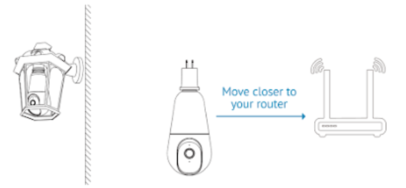

After the camera has been successfully connected to your network, the camera can then be physically installed. This device can fit most standard light fixtures or light sockets. If you need to use the camera outside or in a location far from the router, please use the included adapter to initially set up the device and connect it to your Wi-Fi network using the Amcrest Link app. After the connection is complete, you can then move the camera to the desired location.

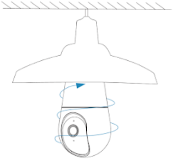

Step 1: Screw the camera into a standard light bulb socket in the direction of the arrow.

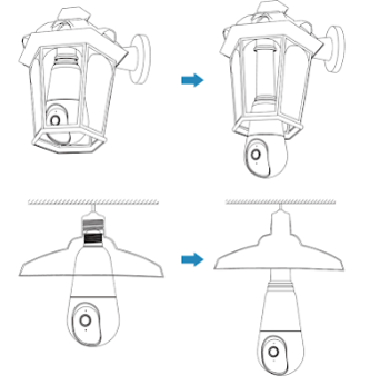

Step 2: An included light socket extender can be used if the light fixture blocks the lens or if it is too narrow.

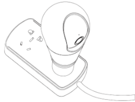

Step 3: The included adapter can also be used to initially connect your camera to your Wi-Fi network.
