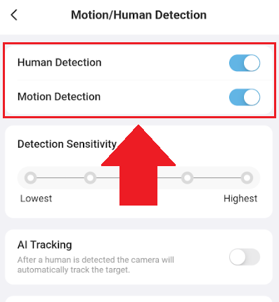

Step 2: Tap Detection Settings.
Step 3: Use the Human Detection and Motion Detection options to enable or disable these options. Enabling motion detection and human detection together will allow both human and basic motion detection events to be detected by the camera.
The detection sensitivity options can be set to high, middle, or low if needed. The lowest setting will have the least amount of objects detected, while the highest sensitivity will have more events. It is highly recommended to keep sensitivity as default (middle) for best results.
The AI tracking feature can also be enabled to allow the camera to track a human once it is detected by the camera until they are out of frame, for more information on the AI tracking feature, click here.
