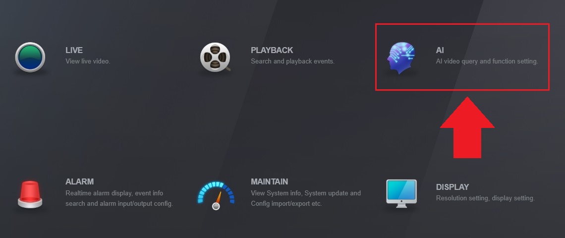

Step 1: Log into the NVR directly or using the NVR's web user interface (web UI) using a web browser and select AI from the main menu. For more information on how to access the web UI for your device, click here.

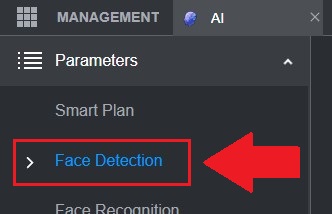

Step 2: Select the Face Detection option located in the Parameters tab.

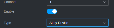

Step 3: In the Type menu select whether face detection will be controlled by the camera or by the NVR. If using by the camera, select AI by Camera, if using built-in face detection, select AI by Device. In this example, we will be using the built-in face detection feature. Click Enable.
Note: If using AI by Camera, please make sure the camera supports this function and a smart plan is enabled on the NVR in the Smart Plan menu.
Step 4: Add any additional notification settings if needed and click Apply.
