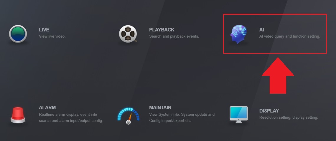

Step 1: Log into the NVR directly or using the NVR's web user interface (web UI) using a web browser and select AI from the main menu. For more information on how to access the web UI for your device, click here.

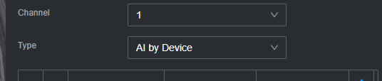

Step 2: Click on IVS. Select if the NVR will use the built-in IVS features from the NVR (AI by Device) or from the camera (AI by Camera). If using AI by camera, please make sure the IVS smart plan is enabled before proceeding. In this example, we will be using AI by Device.

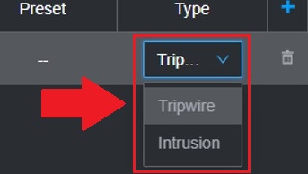

Step 3: Remove the default rule and click the "+" button. Double click the Type dropdown menu and select a rule (Tripwire or Intrusion).
Step 4: Draw the detection area or line on the interface using your mouse and set the parameters of the IVS rule. In the Direction menu, choose which direction the object will enter or exit for the rule to trigger. An object filter can also be applied to detect only human, vehicle, or both.
After applying the parameters, click Apply.
