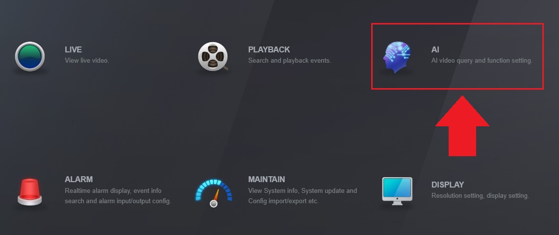

Step 1: Log into the NVR directly or using the NVR's web user interface (web UI) using a web browser and select AI from the main menu. For more information on how to access the web UI for your device, click here.

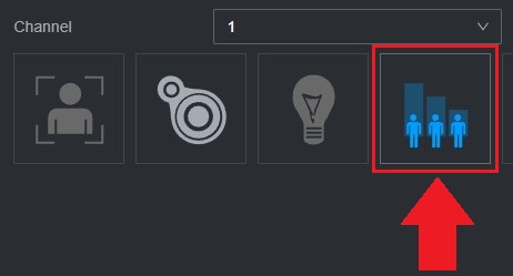

Step 2: In the Parameters section, access the Smart Plan menu. Click on the People Counting option.  Click on Apply.

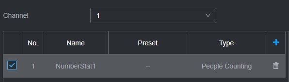

Step 3: Click on the People Counting option located in the Parameters section. Ensure the correct channel is being used and the Enable check box is checked. Click Apply.
To customize the detection area, click on the Draw Area option and your mouse to modify the detection area. To move or adjust the NumberStat1 line, click Draw Rule. The Remove option can be used to remove either overlay. It is recommended however to leave these parameters as default.

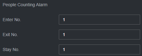

Step 4: Enter the threshold values for the rule. This will signify how many people it will take to trigger the rule. Enter No. will the threshold of people who enter the detection area, Exit No. will be the threshold of people exiting the detection area, and the Stay No. will be the threshold of people who stay or loiter within the detection area.
Click on the More option if you would like to set any further notifications, such as email notifications, etc. Click Apply. The Enter and Exit values can be observed in real time in the overlay in the live feed of the device.

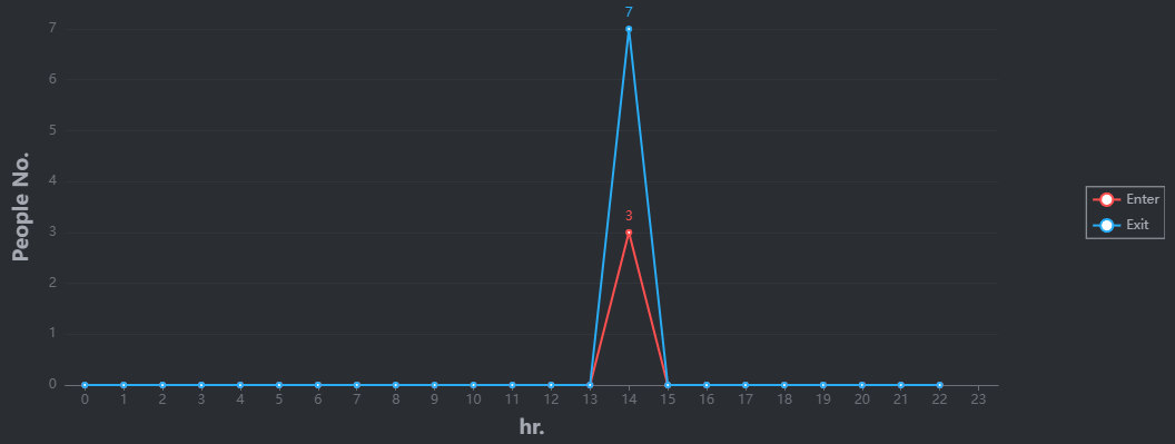

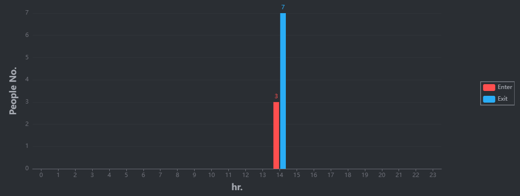

People counting data shows the number of people reported by the system entering or exiting the area within a specified amount of time. This information is displayed graphically using a histogram or a line graph and can be exported to a USB flash drive if needed. For more information on how to view people counting data please refer to the information provided below.
Step 1: Click on the People Counting option located in the Reports menu. Enter a start and end time of the report in the Start Time and End Time fields. To view a specific report, such as a daily report, click on the Report Type menu and select a type. Click Search.
A report will be generated, to view a line chart version click Line Chart.
