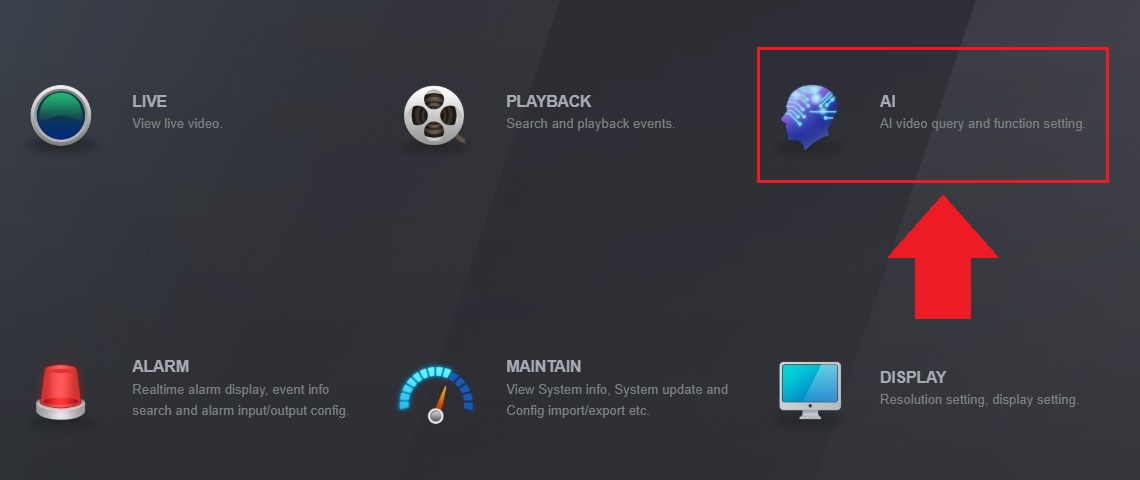

Step 1: Log into the NVR directly or using the NVR's web user interface (web UI) using a web browser and select AI from the main menu. For more information on how to access the web UI for your device, click here.

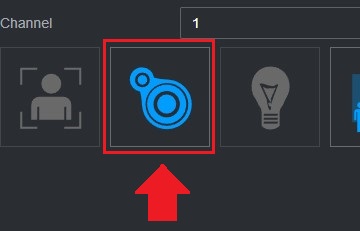

Step 2: In the Parameters section, access the Smart Plan menu and click on the Heat Map option, click Apply.
Note: If a smart plan for heat map is not available in the smart plan menu, it cannot be activated, this may be due to limitations on your AI camera, not the NVR.

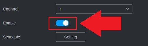

Step 3: Enable the Heat Map feature and click Apply
Note: A schedule can be set for this feature by clicking on the Setting button in the Schedule field. This will allow the feature only to function during specific times set by the user.

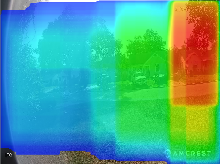

Viewing Heat Map Data
To view heat map data, click on the Reports option and click on Heat Map. Select an increment of reporting in the Period dropdown menu. If you would like a custom reporting of the events, enter a start and end time into the interface and click Search.
Note: To back up a heat map image, click on Export then click Save. This will save a BMP image to your computer.
