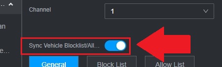

Step 1: Log into the web UI or local GUI for your NVR and access the AI menu. Select ANPR. For more information on how to access the web UI, click here.

Note: If the IPC has any vehicle block or allow lists you you would like sync, Enable the Sync Vehicle Blocklist/Allowlist. Once synced, new plate information can be entered from the NVR directly using the Block/Allow List option located in the Database menu.

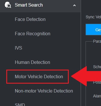

Step 2: Once license plate events have been detected, access the Smart Search menu and select Motor Vehicle Detection.

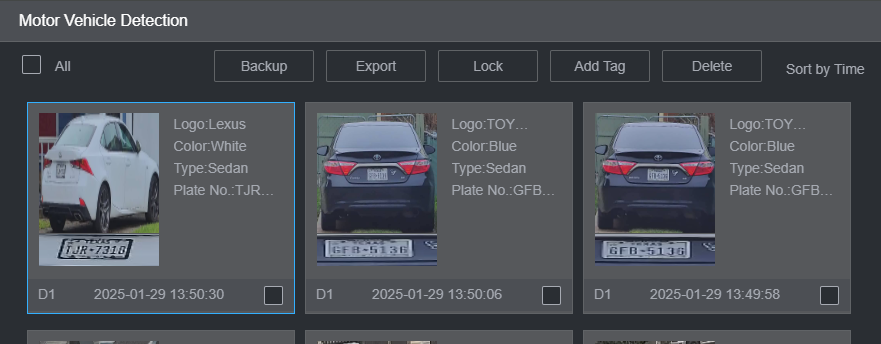

Step 3: Input a custom time range for the events, or use the Period menu to select a range of events you would like to view. Click Search.
Note: If you would like to view only specific plate numbers, enter the the license plate details into the Plate No. field. To view only plate events from detected.
