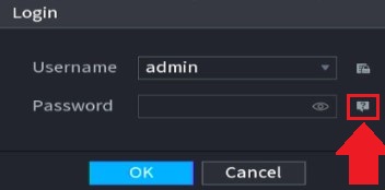

Step 1: On the local interface, click on the "Forgot Password" icon in the Login screen.

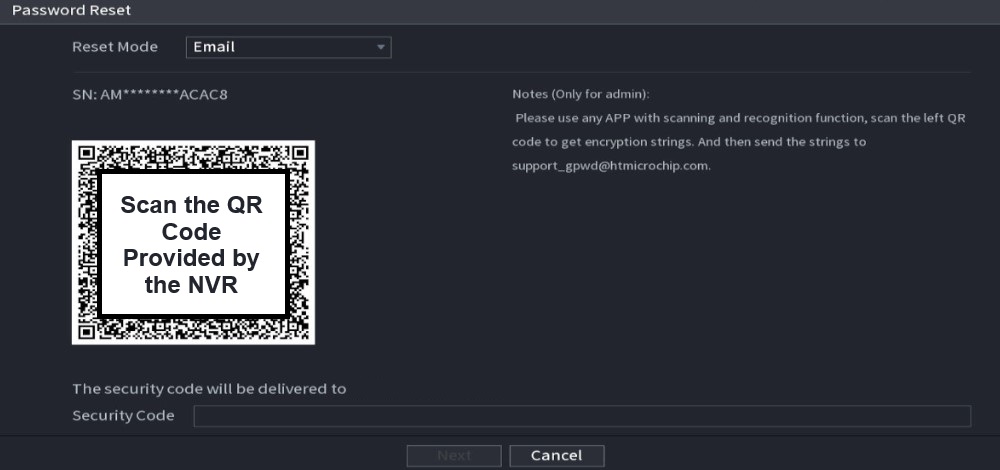

Step 2: A QR code will be displayed on the screen.

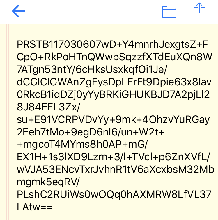

To proceed, scan the QR Code, on the screen, you will notice a special string for text.
Copy and paste this information into an Email and Email it to support_gpwd@htmicrochip.com
A confirmation email will be sent to you with a security code. The confirmation email will be delivered within a 24 hour period of sending the Email.

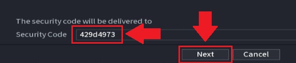

Step 3: Enter the provided security code into the "Security Code" field and click Next to continue.
