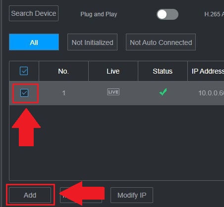

Step 3: Click Device Search to allow the NVR to search for compatible cameras and refresh the device list. Make sure the "Status" has a green checkmark, select the camera, and click Add.

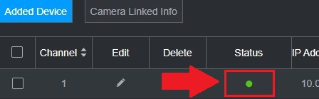

Step 4: If the status is red it could indicate the camera has not been properly added to the NVR and the password for the camera needs to be updated. Select the device and click the Edit button. Enter the camera's password and click OK. Select the device and click Refresh to verify the camera's connection status. It should be green indicating the camera is properly added to the NVR.
