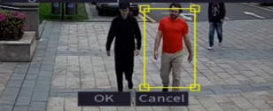

Step 2: Locate the object on the screen and use your mouse to adjust a search area around the object. Once the area is set, click OK.

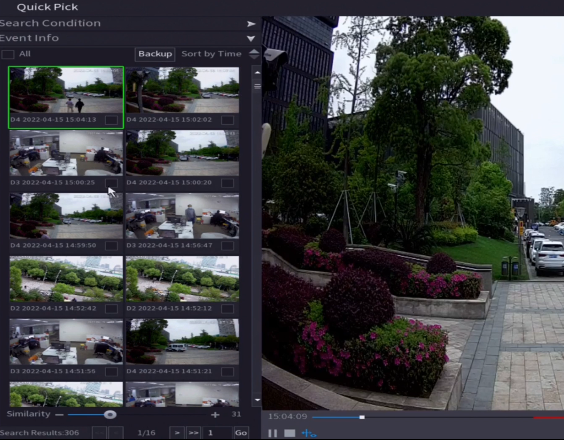

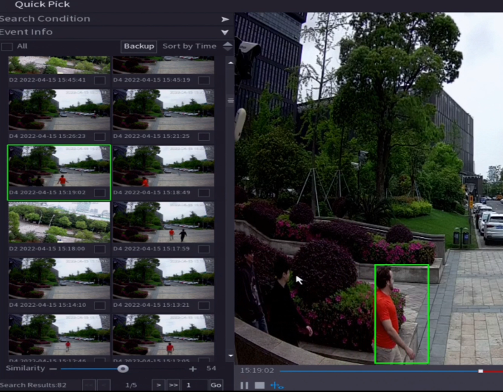

Step 3: This will launch the quick pick interface. Locate the similarity events and select or play an event.
Note: If you would like to export an event, insert a USB flash drive into a USB port on your NVR and click Backup to export the event to the USB flash drive.
