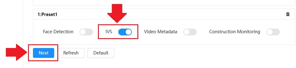

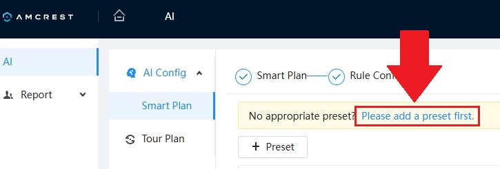

Step 4: Click + Preset and add the preset into the interface. Select the IVS option and click Next.

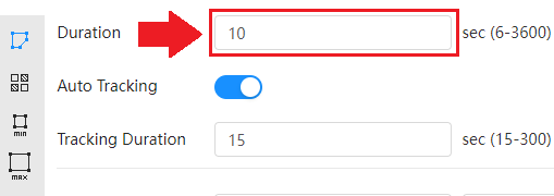

Step 6: Click Add Rule and select Abandoned Object from the dropdown menu. Use your mouse to draw a detection area on the interface.
By default the rule will be set to trigger if an object is within the detection area for a duration of 10 seconds. However, you can adjust the duration if needed from 6 - 3600 seconds.

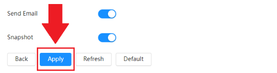

Step 7: Click Record to retain events to a microSD card. This will allow you to view IVS events in the playback menu. Select any additional options, such as a siren, which will allow the camera to produce an audible siren, or email to send a notification of the event to an entered email address. For more information on how to setup email alerts, click here. Click Apply when finished.
