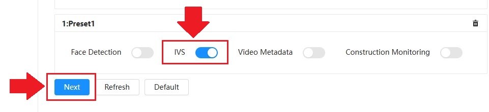

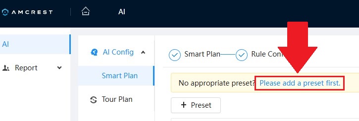

Step 4: Click + Preset and add the preset into the interface. Select the IVS option and click Next.

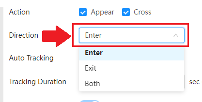

Step 6: Click Add Rule and select Intrusion from the dropdown menu. Use your mouse to draw a detection area on the interface. Please note, an option effective target filter can be set that will allow the rule only to trigger when a human or vehicle crosses the line.
The rule can be set to trigger an event if an object appears or crosses the detection area. If Cross is selected, you can choose to trigger the rule if a object enters only, exits only, or both.

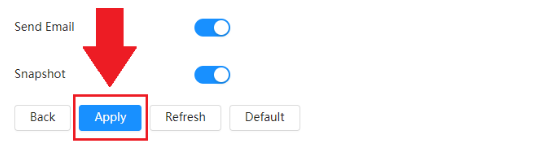

Step 7: Click Record to retain events to a microSD card. This will allow you to view IVS events in the playback menu. Select any additional options, such as a siren, which will allow the camera to produce an audible siren, or email to send a notification of the event to an entered email address. For more information on how to setup email alerts, click here. Click Apply when finished.
