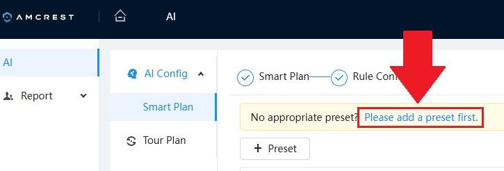

Note: If a preset is already established, click + Preset to add the preset.

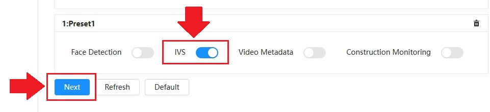

Step 4: Click + Preset and add the preset into the interface. Select the IVS option and click Next.
Step 5: Click IVS.

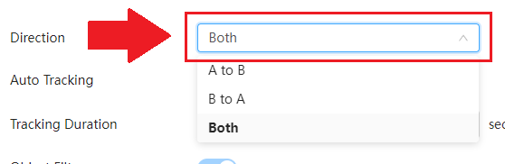

Step 6: Click Add Rule and select Tripwire from the dropdown menu. Use your mouse to draw a detection line on the interface. Please note, an effective object filter can be set that will allow the rule only to trigger when a human or vehicle crosses the line.
The detection line can be set to detect object from different directions, A to B (objects entering left to right), B to A (objects entering right to left), Both (objects entering from both directions.

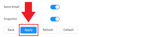

Step 7: Click Record to retain events to a microSD card. This will allow you to view IVS events in the playback menu. Select any additional options, such as a siren, which will allow the camera to produce an audible siren, or email to send a notification of the event to an entered email address. For more information on how to setup email alerts, click here. Click Apply when finished.
