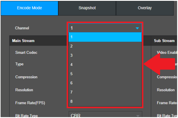

Switching to H.265 Compression Using an NVR
Step 1: Log into your device locally or using a web browser. For more information on how to access your device's web user interface (web UI) click here.

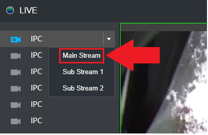

Note: If using Google Chrome or other mainstream web browsers the sub-stream for the device may be displayed in the interface by default. Please note, some older computers may not be able to support H.265 compression which may result in a corrupted file. To change the live view to the mainstream, click on the stream selection dropdown menu and select Main Stream.

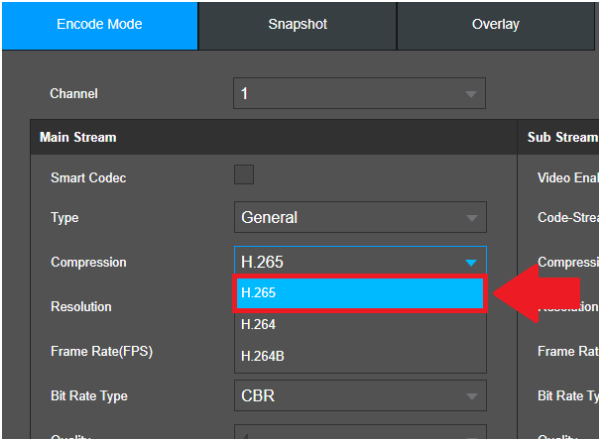

Step 2: In the Management section, click on Camera and access the Encode menu. In the Encode menu, choose a connected device from the Channel list.
Step 3: Locate the Compression dropdown menu and select H.265.
Step 4: Click Save to save your settings.

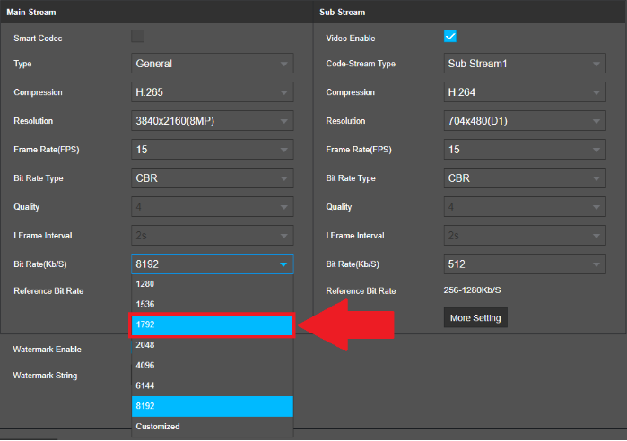

Since H.265 compression uses roughly 30% fewer resources than H.264, the camera will typically come default to a preset bitrate when switching to H.265. For instance, when switching to H.265 on a 4K camera, the bitrate may be defaulted to 8192 Kb/S, however, adjusting the bitrate to a lower value may help to increase the efficiency of the camera while viewing playback or watching the live view.
To adjust the bitrate, access the Encode menu and click on the Bit Rate (Kb/S) dropdown menu. A list of preset bitrates will be displayed as well as a Customized selection which will allow you to set a customized bitrate if needed. Please note, when using a 4K camera, it is recommended to keep the bitrate around 1792 Kb/S, however, different values may be applicable depending on your specific network requirements.
Note: In this menu, you will notice a Bit Rate Type menu, this dropdown menu allows you to choose between a constant bitrate (CBR) or a variable bitrate. A constant bitrate allows the bitrate to remain constant whereas a variable bitrate allows the system to choose a bitrate. It is highly recommended to keep the bitrate type as CBR to keep the bitrate consistent.
Please refer to the table below regarding the recommended resolution and bitrates and custom thresholds.
For more information on how to adjust the bit rate, please refer to the information provided below.
Note: Adjusting the bitrate to anything lower than the recommended bitrates above may result in degradation to recordings or to live view. For best results, if you are adjusting multiple cameras, it is highly recommended to adjust each camera individually. This may be a trial and error process since most network environments are unique and may vary, however, the bitrate should range between 1792-2048 Kb/S if using a 4K camera. An optimal customized bitrate should be around 1825 Kb/S.

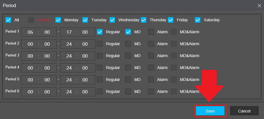

Setting Up a Recording Schedule

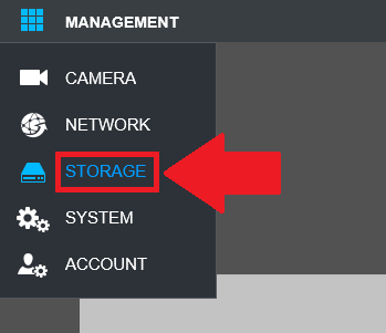

Step 1: Log in to the web UI for your device and click on Management and select Storage.

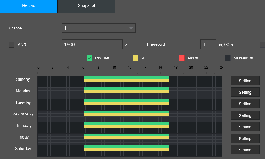

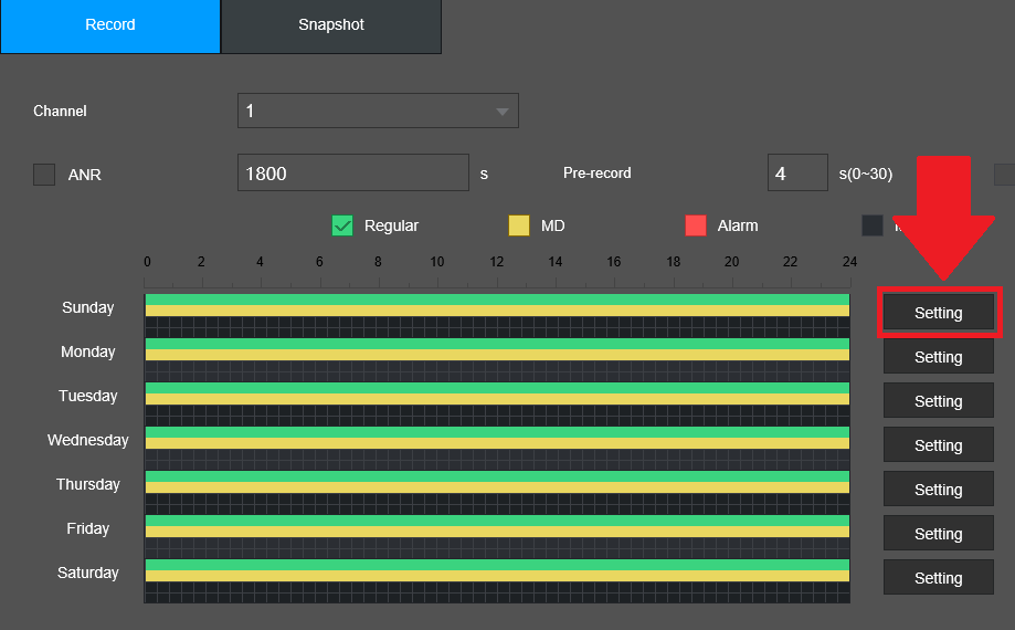

Step 2: In the Record tab you will notice a series of days on the left of the schedule and the number of hours at the top (specified in increments of 2 hours). You will also notice 4 checkboxes representing each recording type. Please note, if using an AI NVR, a fifth recording type (IVS) may be preset. Click Setting to begin customizing a recording schedule.
Step 3: Select which day of the week you would like the recording schedule to apply. If you would like the schedule to apply to all days of the week, click All. Select which recording type you would like to use, which in this case, we will select general, and motion. Set a time of day in which the type will be applied. For example, in this case, the recording schedule is set to be active from 0600 (6 am) - 1700 (5 pm)
Note: The timeframes will be formatted to military time.
Please note, a total of 6 separate periods can be set up at a time which will provide different recording schedules to be active for different days of the week.
Step 4: Click Save to save and apply the recording schedule
The recording schedule will now be set to record only on the specified dates and times chosen.
