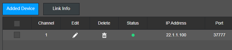

A wireless pairing interface will be displayed and will list all Wi-Fi cameras detected by the system. A pairing countdown will begin, once the countdown is complete, the Wi-Fi cameras detected by the system will be paired and automatically assigned to an open channel. If the camera is not initially displayed in the Add Device menu, click on the Refresh button to refresh the interface, and display the newly added device.

This can apply to Wi-Fi cameras or PoE cameras that are already registered over the network. Please make sure the NVR is connected to the same network segment as the cameras before applying this method. To register the cameras, click on the Device Search button in the remote device menu and allow the NVR to locate the cameras. Select the device or devices from the interface and click the Add button to add the cameras into the system. If the status of the cameras remains as “red” in the system, click on the Edit button next to the camera and enter the correct password for the camera into the interface and click Save.
