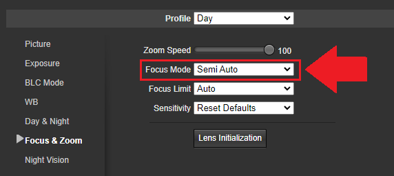

Step 3: The focus settings can also be adjusted in the interface if needed. To access these settings, click on Setup>>Configuration>>Focus & Zoom. By default, you will notice the focus mode is set to semi auto. This means the camera will automatically adjust focus only when you use the zoom function.

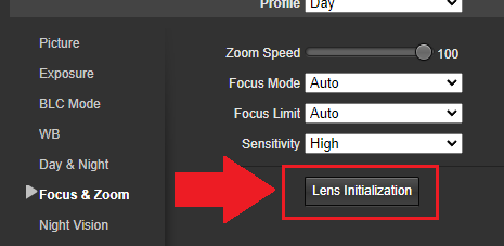

To set the device to automatically adjust focus, set the Focus Mode to Auto. The sensitivity can be set to default or high depending on the environment being monitored. Once these settings have been saved, click Lens Initialization to optimize the image and adjust zoom and focus accuracy.
